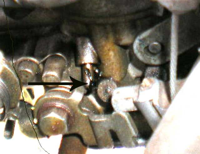

There is only one vacuum hose on the carbs. There are 2 hoses that are on the bottom of the bowls for the overflow.
There are brass nipples on the inboard sides of the carbs, these are the float bowl vents and should have no hose or caps on them.
This pic shows one of the float bowl vents and the gunk that I blew out of it by putting an air hose on the inside. As I said these should be left open and checked to be sure they are clear.
Posted Image
